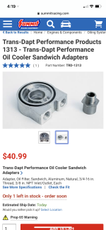

I had thought about something similar before. But instead of that setup, using a sandwich plate with the same 3/4-16 thread and adding a small external cooler somewhere. My yard isn’t too big, but when I was cutting a couple properties, the thought had crossed my mind.

The thread size for the filter on the FR651V is the same 3/4-16 size, so it should work the same. Depending on where the sandwich plate aligns when it’s tight on the block, the location of the fittings going to the cooler could come into play. Most of the 1/2” npt fittings are fairly short, and some -6 3/8” push-lock hose is about $3/ft. I’ve had good luck with the push-lock hoses, but have built countless braided line hoses.
edit. This one is quite a bit cheaper at $41.
