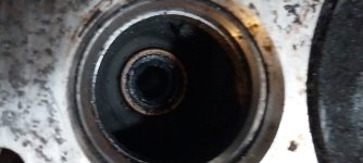

Ok another question. The valve seal was broken. So how do I remove the old one?
Thanks.

Valve seals , if you by new seals possibly install instructions come with them . Long shot ? yes but free .

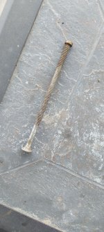

Finally got the seal out with a long carriage bolt. Tried needle nose pliers, seal pick, bolt extractor.

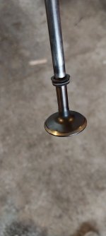

Bought a cheap lapping tool for a drill. Figured it should work for just 2 small valves. Didn't last 5 minutes. Tool went right through the rubber suction cups.

I used my son's old tooth brush, they have a suction cup on the bottom. Twirled it with my hands to lap the valves. I've read and heard your supposed to clean well after, to prevent any grinding paste getting into the cylinder. Good luck.

Thinking about just getting the sticks. It's just 2 valves so they should survive. Gasket surface and chamber cleaned up real good. Used a 3M round thing, don't know what it's called, that goes on a drill. Used that when I replaced the cylinder head on my Liberty. Really does a nice job.
I also got thinking about the mower. Before I quit using it it would smoke when I started it. Then it would stop smoking after a short while. First thing I thought was the rings. But maybe it was just the seal broke and leaked oil into the chamber. Piston seems snug in the cylinder.
