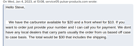

I managed to get in contact with Pulsar directly. I actually even got a couple of return emails from them. Take a look at the screenshot below. Notice the second sentence. It's a bit hard to decipher but what is says is that they don't have ANY local dealers that sell parts. Instead, they sell parts on a "case to case basis". I'm not exactly sure what that is supposed to mean. LOL! All that matters is that I can get the carb for 20 bucks.
Other than that, I wouldn't actually need anything else from them except an air filter. I'm 99% sure I can straighten that bent bracket, either myself or one of our local machine shops. I'm just going to remove the entire front axle assembly with the brackets attached and try straightening it. I won't risk messing it up. If it won't straighten up for me fairly easily I'll let the machine shop do it. I don;t have a press anymore. One more thing I sold when we moved into town that I now wish I had back.
