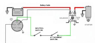

Gravely ZT48 XL - only single click when starting. Replaced ignition switch, starter solenoid, starter, seat switch, cleaned battery terminals, tested starter relays (they were good), battery tested showing 12+ charge. Any ideas? The only thing I can think to do now is replace wiring.
Read the instructions in the pdf file first. I listed one from Amazon. It is purpose built for John Deere. You can buy a 30 amp Bosch relay at the parts store and make up your own wiring for less.
