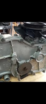

Thanks much. That is conclusive enough for me, they have 1" axles. So the double D (DD) would indicate 1" axle. What was most confusing for me is the fact that my pulleys are on top of the fans, on all the pics I see of the ZT-2200 EXT the fans are on top of the pulleys. I guess they can be either?

Thanks. I did see that the other day. Mine is a 2200 EZT, but has the fan/pulley set up like it shows on the 2100 on their site. I changed the oil in both hydro's yesterday and EZT is cast into the side of the case. I attached a pic, hope it shows it.

Kevin you going have to accept the transaxle is a ZT-2200 (EZT) and the fan pulley order is correct. Don't get stuck in a rut.
