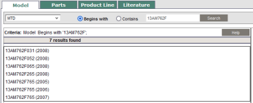

The tag says: 13AM762F Yard machines by MTD 638 AL

First the model given is missing the last three digits. So which of the follow 5 versions is it?
