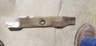

JD Z245. This is one season on these blades. Guy lives on a farm. I just finished scraping still wet grass from last season out od the deck. It was packed so bad the grass was down to the blades. Had to use a pry bar to get most of it out.

This is the third year i will change the blades after one season on this mower.

Holy cows, does he till with these blades?
#5
Hammer you going need to go on a diet. Look what you did to the concrete slab.
Have tried installing heat treated blades. They usually last twice as long as regular blades.

I bought JD OEM couple years ago. They were not like the Marbain blades most JD mowers have. They were just like an OEM Oregon or MTD blades. The Stens AM blades are only $8 apiece so i just put new ones on each year. I am suprised how well the mower has held up with what he does to it.

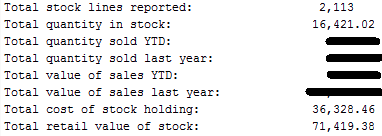

B
I needed a single spindle like that but i bougt a 3 pack. It was like buy 2 get one free vs buying 3 individual spindles.
I don't have a large on hand inventory and i just keep it in an open office spreadsheet. Mostly air, oil and fuel filter, spark plugs, fuel line, deck wheels and carb stuff.
No blades ?
I see Stens do bulk packs in the US at a good discount over the single price.
Down here they only sell single
What I do miss is Oregon Gators which B & S is not going to import .
I probably sold 30 sets a year
Hopefully a local importer will start bringing them in direct .

Those look pretty good compared to some I have seen had one come in with half a blade on it.
#26
7394
7394
I'm surprised the sails didn't break off that blade.. Both are cracked badly.
I made me a scraper to clean under the decks when I service mowers. It the scraper the carpet layers use to get the pad up. I just ground it where it is narrower so I can get in the front part of the deck where the lip is. Works pretty good but there are some where your really have to work to get the packed in grass off the deck.
Looks like he's got the deck set pretty low to the ground and cutting very overgrown grass and/or he's going over big patches of bone dry aggregate. Signs of sand, pebbles and dirt by the wear marks on lift area. Jeez the wear on the blade edge isn't from just grass IMHO.
He must be cutting a couple of hundred of acres of hay for a few hundred cattle , wow , I'd say maybe 4 or 5 years of cutting.
Why do you keep putting mulching blades back on it? All of the damage that's being done and the packing of grass under the deck is on you and your lack of knowledge for what your doing. Everyone is so quick to knock and blame the people that are putting food on your plate. Punish them by charging extra instead of evaluating the circumstances and fixing the problem.

F
fixit1ddh
Mowing to fast with dull blades. Does it everytime. Does not matter what kind of blades they are.
Glad to see you know everything about the situation. Thanks for correcting me i feel so stupid and i should have known.
The mower is around 20 years old and he bought it used and abused. He knows exactly how bad he beats the $hit out of it. He is on a farm and he uses it. Like a bushhog and mows a very long gravel driveway and he knows mowing in the rain is bad but he still does it. When it breaks he just says see if you can save it. He calls me the mower magician because i keep it running. If you think i am ripping off a customer due to lack of knowledge or integrity please feel free to not bring me something to work on.
Hes a lazy jackass. These are the first people to cry about wanting warranty work.
I was going through two sets of the high-lift blades per season on my YTH-2348 due to the fine sandy soil I have here that got sucked up and sand-blasted them far worse than the blade pictured... I ended up switching to mulching blades and only had to dress the blades once last mowing season instead of a couple times per set for the high-lift blades... They're good to go for this season and maybe beyond that...

I have a craftsman DGT6000 54" deck .2.2 ac. still using the original blades .Shharpen when needed. only 17 seasons old.

What's he been cutting, a rock garden?

Sure looks like a Rock Garden..
#47
Scrubcadet10
Scrubcadet10
I think its more of a rock farm than a garden ???
#48
Even my blades looks rough after a year of cutting my grass. Fescue is rough on blades plus cutting up to 6 acres don't help a lot either. Several mow a lot down tree limbs [twigs] with their mowers. Kinda hard not to; unless, we are constantly raking our whole yards weeks before mowing.
