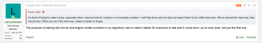

I’m tired of trying to make it easy, especially when I have to look for numbers or incomplete numbers. I will help those who do that, but expect them to do a little work also. We’ve learned the hard way, they should also. When you do it the hard way, makes it harder to forget.
The purpose of placing the mower and engine model numbers in my signature was to make it easier for everyone to see and it would show up on ever post, not just the first one.
