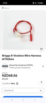

Cut the plugs off leaving some wire to work with, strip, twist, solder and heat shrink. Don't just barrel crimp and call it done. Not water proof. Will last for many year and save you $$ and shipping costs.
Doofy
Aug 22, 2018
5
I keep an assorted bunch of cheap Male/Female connectors on hand just for these types of problems. Make your own and Be Happy!
