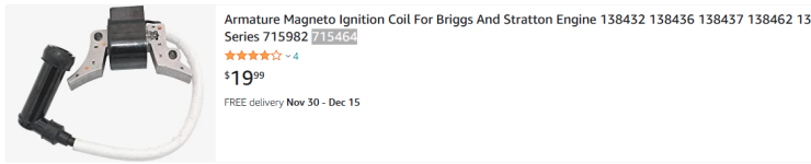

Might try getting an aftermarket one through Amazon. USA price and delivery time out of China.
Thanks for pointing that out. Really want to avoid non Briggs parts if possible. I searched on the forum and it was mentioned about sanding the coil and it being a problem on the Vanguard engines? Has anyone had any experience with the grounding issue and sanding to clear the warm engine cutoff issue?
