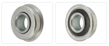

Can also an axle flange bearing failure.
