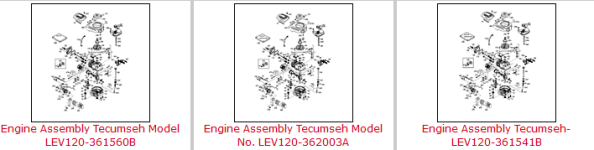

Here go again...You are providing us with info haphazardly. I am surprised you even getting the right parts.
Multiple engines used, luckily they all use the same Tecumseh TEC-640303 5268 Mfg. No. Carb.
but here is the serial breaks for the Toro 20017
and here is the three known engines that was used.
And here is link to 640303 carb 5268 mfg id carb IPL.
But as Rivets did I stepping out of this thread too.
