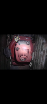

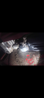

toro 6.5hp float stuck leaks all fuel out and died wont start
This is the mower toro 6.5hp GTS. It was bought new in 2004 and has always started first pull. One thing is the primer bulb is getting older 20 years old so possibly best to find the carb part number and can go from there.

You know about carbs, but can’t find numbers? How do you know needle and seats are $10 and carbs are $15 if you don’t know the model number and serial numbers? Second the Toro GTS series mowers came with a Suzuki or Briggs engine, depending on the age. I highly doubt any good carb for these engine can be found for that price. Something is starting to smell like old fish in this thread.
Yeah lol I had searched the model number that was on the riding mower sticker when you open the hood. Has blade, key, belt part numbers I attached photos in above post.
Justwayne you are going have to learn that the true model numbers are listed on the serial number tags. you can't just go by things that OEM put on equipment for the consumer to look at. But as a repair shop we must have the correct numbers in order to get the right parts.

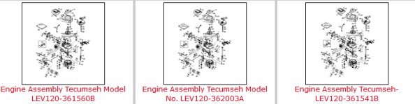

1. You have a Tecumseh engine.
2. If you look under the discharge cover you’ll find a Toro model and serial numbers.
3. If you look under the red engine cover you’ll find the Tecumseh model and spec numbers On the side of the engine shroud.
4. I hope that when others chime in on your problem they are like you, definitely smarter than me, you will listen to what they tell you

This is it i bought one for the riding mower same 16$. The other was exact same design as factory one i took off and kopt it just incse. The only thing here would be it has the gaskets to not leak fuel or leak an empty tank after a few months not just the floa, needle and seat.

Multiple engines used, luckily they all use the same Tecumseh TEC-640303 5268 Mfg. No. Carb.
but here is the serial breaks for the Toro 20017
and here is the three known engines that was used.
And here is link to 640303 carb 5268 mfg id carb IPL.
