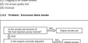

Well, the Toro 223D is back to almost not starting. Cold, I have to grind on the starter a long time with tons of black smoke. I have to play with the throttle and the glow plugs while cranking. Once (and if) it finally starts, lots of black smoke then finally clearing up. Retorqed the head, reset valves, replaced injector nozzles. No change. Could the injector pump itself be the problem. It seems to be getting progressively worse. I have a Dahatsu diesel engine in a Toro Z Master parts machine that runs good. Thinking about giving up on the Mitsubishi and swap the Dahatsu in.
Service book on Mitsubishi L3E engine in trouble shooting section, says the first thing to check for excessive black smoke is adjust smoke set. No where in the manual can I find hoe to adjust smoke set. Anyone have any idea what they are talking about?Screenshot from 2024-04-21 07-29-55.png
