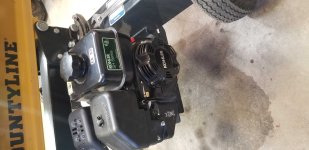

Brand new log splitter won't run. A guy's daughter bought it for him for his birthday and hauled it a hundred miles to him. The "Kohler" engine is a chonda clone. Pulled the carb and it is identical to a $15 Ebay carb down to the markings. Nothing against the clones as they run fine. I wonder how much that Kohler sricker adds to the price? Tractor supply aslo delivered it 2 gallons low on hydraulic fluid.

It probably set for a long time at TS and there was residue in the carb fuel shutoff valve blocking the fuel. Obviously TS didn't start it when she bought it. $1200 splitter and they didn't even try to start it.

Well first is that a Metric adjustable wrench laying there?
And it even looks a clone. I wonder if Kohler is building them or just having them dressed up.
Anyway the Service manual for the SH265 is the 3000 series service manual.

Yes, my metric adjustable wrench lives next to my metric hammer in the toolbox. I do have a set of metric screwdrivers JIS
I can tell you it is definately a china built clone. Pretty much every part looks identical to a clone i have.
Here is the 6.5 HF predator. Almost an exact copy except for air cleaner and tank.
HF sells them for $160. How much does Kohler pay?

Local TS said to take it back to where she bought it. A hundred miles away. I have put dozens of cheap clone carbs on clones and Hondas with no problems. Don't have that luck with real Kohler and Briggs engines. All it needed was to clean the sticky gunk out of the carb fuel shutoff. Lots of Honda style carbs are replaced because people don't know where or how to clean the tiny pilot jet.

Bring it to me and fixed in 30 mins. Charged $40. Splitting wood that afternoon.
