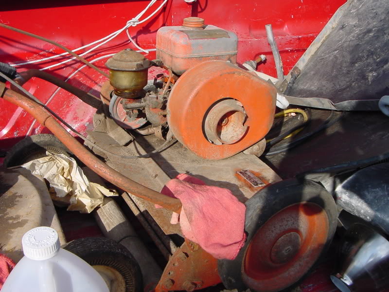

With those model numbers I was able to locate some photos. This, I believe, is a J125 from the late 1940s or early 1950s.
