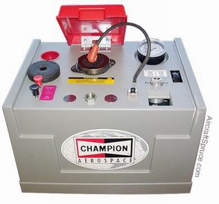

6) next the plug has to fire at cylinder compression so proper testing is done at the pressure appropriate for the engine in question .
Proper plug testers fire the plug at the proper frequency for the engine they are to be used in . They are tested by varying the voltage in a fixed pressure ( appropriate to the engine ) then at a fixed voltage , appropriate to the ignition system and varying the pressure.
The machines used to be given away to mechanics who sold better than 2000 plugs a year or could be bought for around $ 10,000.
The time taken to set the machine up plus the operating costs ( it uses compresses air & electricity ) plus the testing time have to paid for some how which can again only be added to the price of replacement plug or the engine service.
