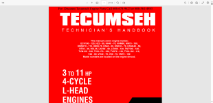

You are way over thinking this. Don’t even need to remove the engine from the equipment. To check for scoring all you need to do is remove the head and look at the cylinder. A good mechanic can quickly ( in 15 seconds ) identify a cylinder which has been damaged. You only need to be able to see the top 1/3 of the cylinder. Have you even looked at the manual I posted?
Looking now.
