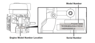

Poulan Pro 624 ES 961920037-00
Engine is LCT 208
110
12,249
Okay need the engine numbers.
Going to a long number like PW4HK18650178EABGIOQUVX5E1M or similar Alpha-numeric seq. in order to look-up the right carb.

IL your eyes are better than mine as it took a lot longer to translate that dot matrix number set.
PW2HK18650178EABGIOQUVX5E1M​
