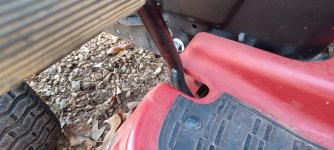

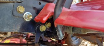

LOL soooooo on to my next installment of the process to fix this thing. After failed attempts to get the back wheel off, I started to look forward to where the clutch/ brake linkage connects to the peddle. As soon as I got this thing I noticed the clutch peddle was really far forward and difficult to reach. I'm 5'8" so I'm sure Craftsman (or whoever makes these things) intended for someone my height could use these and not someone 6'2". So I started thinking maybe there is an adjustment up front and no need to mess with the rear wheel at this time. I found two bolts under the clutch peddle and it looked like I could make an adjustment from there. I loosened the two bolts and tried to maneuver the plate behind the bolts as best I could (of course I have no idea what I'm doing) I started the mower, put it in gear and rode around the yard and I'm able the shift a bit better but, I don't have either a main brake or an emergency brake. I feel like I'm getting closer to solving the problem... I just need to get over the hump. Looking at where the clutch comes up from under the frame It seems to me that it should be closer to my feet.

If you can find an inexpensive replacement rim, you can always Sawzall the wheel to make a slit, then pry to widen the slit and pull it off.
As to your original problem. Have you checked the brake pads and cable / bar tension? Lots of mowers use a pad that wears, and when it does the belt geometry and behavior changes. Sometimes it will cause slippage, sometimes it will fail to brake the pulleys.
