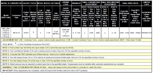

He must have some mighty good hearing if he can tell the difference between 11,000 rpms and 10,900 rpms. For me that takes a tach to done that. Even the idle settings should be done using a tach when tuning by the factory service manuals.
Here is an example where the max rpm are drop by 20 rpm though a mx rpm is allow it is still better to enrich a tad.
And this one of the simple tune ups on the Echo line.
