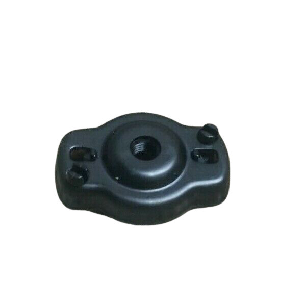

Should look like this....

Yes, that is exactly what it looks like when pulled apart. My problem is that when I reassemble the unit, the pull cord only comes out with difficulty and won't retract. If I loosen the bolts, then it will retract but won't turn over the engine on the pull. I'm just wondering if I don't have this unit correctly aligned or if there is some particular trick to how much to tighten the bolts. I wouldn't think that would be an issue but then that's why I'm here, hoping to learn.

You need to pull the rope back and forth while putting the starter back on, and make sure the starter cup meshes properly.

Thanks, I'll try that tomorrow. Is the starter cup the gray/black item on the right in your picture above? I appreciate all your replies and help!!

Yeah, not really a cup looking thing,
just all I could think of to call it.
11,403
  • / Stihl FS56RC Pull Cord Housing Reset but Cord won't pull?
Stihl calls it a driver.

Appear they call it by several different names. How typical of them trying to confuse us.
From the 03-2012 IPL
14 4140 190 2010 1 Driver
☐ 15, 16
15 0000 998 0612 2 Torsion spring
16 4133 195 7201 2 Pawl
