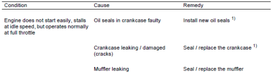

The only to test the coil other than very factory tester is with the coil mounted on the engine with the flywheel magnets flying pass it. NO ohm meter tests as it is impossible to the electronics via an ohm meter.
Two strokes require both crankcase compression as well as cylinder compression
Crank case compression is controlled by the seals at each end .
You test them in both pressure & vacuum
One of the signs of worm seals is engines that are very hard to start cold but start fine during use
Or start very hard on Friday afternoon, work perfectly all weekend but be impossible to start next Friday when the seals have dried out again.
Joe Pace did a series of 2 stroke diagnostic techniques and this is the one on Crank Case Testing
It takes about 1/4 to 1/2 hour to do if you have all of the gear on hand .
If some one comes in and asks me to test their trimmer I charge 1/2 hour same for a blower and 1 hour for a chainsaw .
