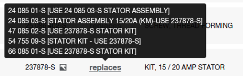

I'm working on a Kohler Kt735-3051 on a 2016 Hustler Raptor 52". Previous owner said the engine "wasn't getting fire", so he took the top off of the engine and left it outside under a tarp. The stator and coils are completely rusted so I ordered new ones from Amazon. The original stator has 2 posts that do not have copper winding around them so it is 4 with, 2 without, 4 with, etc. The new one has winding on all posts. Both are supposed to be for 15/20 amp charging. My question is, are they interchangeable? Also, all the magnets had come loose from the flywheel and were stuck to the old stator. I reattached them using JB Weld and being careful to align the pos/ neg. on the magnets according to the directions in the manual.
Any insight will be greatly appreciated.
