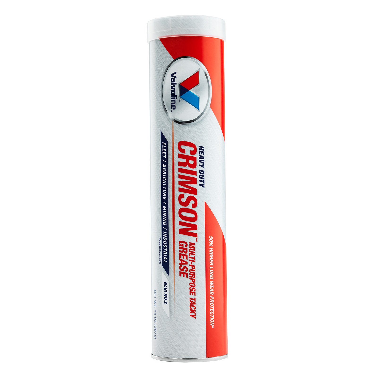

Look at Valvoline's lineup of heavy duty grease. There are a couple that will do the job.

Decided to go with
Schaeffer Green Extreme Pressure Waterproof Grease NLGI #2. Good for high temps also. Thanks for replies. Will check out all suggestions.​
