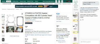

the amazon gasket appears to be the correct gasket however the bot is confused as usalesnapper gasket bot is confussed.jpg.
