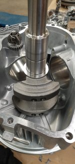

does anyone know how the rod bearings are designed get oil on a 27hp 49T877 series Vtwin?
there's pressure passages from the pump ported thru the case that flows thru the cam to the crank main journals and there are 2 oil holes in the crank rod journal but they dead end there and do not connect to the mains on the crank?
cant for the life of me see how the rods get oiled on the big end,
this is a new motor had a knocking rod and I'm wondering is it possible the crank wasnt cross drilled from the mains to the rod journal and they sent it like this from the factory? or is it not pressure fed to the rods? anyone have a repair manual that shows the lubrication pathway?

It's apart and the crank is definitely not drilled from the rod journal to the mains.

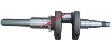

Rotate the crankshaft 180 degrees.
Here is an image of the crankshaft itself with line showing oil passage to the rod journals

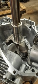

Thanks, On this crank, there's absolutely no passage from the rod journal to the main on the pto side, had a feeling it should have been cross drilled but it wasn't.
Must be a factory flaw and that's why the rod was knocking.

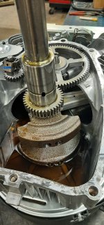

I pulled an identical motor apart... the oil passage to the rod journal is right where it supposed to be.
Evidently someone was asleep in the crank drilling dept.
This crank has no oil passage to the rod journal.

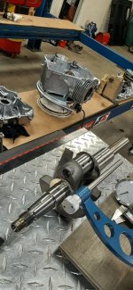

Just drill it out and polish her over. You have a perfect picture of what it should look like.

Cast, shouldn't be bad drilling, need a .210" bit long enough to reach the rod journal.
And a good way to clamp it at the proper angle....but that's what it's looking like.
