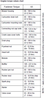

I am looking for technical info on the engine. Things like the torque specs on the crankcase bolts and a tightening pattern and the torque spec on the connecting rod bolts
Any ideas on where I could get service manuals for it. Thanks again
