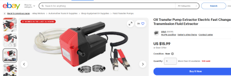

I asked the shop and they said they don't use this oil drain plug to remove oil. They use a tool to suck it out of the pipe through which we put in the oil. But this thing is about $250. Is there a cheaper alternative? I'd rather open the oil drain plug though.

They make smaller oil extractors that are cheaper than the one in your picture.
If money is your issue, you could just make yourself one. I mean a paint can, drill 2 holes - 1 for extraction hose, 1 for vacuum to suck the oil out into the paint can. You can get fancy and get 2 rubber grommets for the holes.
