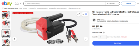

I got one of these. Cheap and easy. No pumping just hook it up and go.

They make smaller oil extractors that are cheaper than the one in your picture.
If money is your issue, you could just make yourself one. I mean a paint can, drill 2 holes - 1 for extraction hose, 1 for vacuum to suck the oil out into the paint can. You can get fancy and get 2 rubber grommets for the holes.
