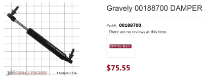

Well just go ahead and listen to them but this is the part that Gravely has for the ZT HD 60 [991038]. But you should post the 6 digit model number for us to look up the correct mower and the correct part as there is about 15 variations of the ZT 60 HD mower. Without the correct model the part guy is just guessing at what you have in front of you. And yes there is at least two version of the damper.
Just one Example:
Just

Sorry 'bout that. It's an 991156 and the damper part # is 09689700
EDIT: OK I think I've got it. Apparently you slip a small skinny flat-head screwdriver & pry the little 'grippers' out of the way & slide it over the pivot head. Then release the 'grippers'. Probably easier said than done. Might require an adult beverage for this one..........🧋
87
11,110
Now that makes a difference as it has different dampers than the one here.
Still might be easier the remove the studs and then disassemble after you got the damper(s) out. At least you would more room the work on them.
