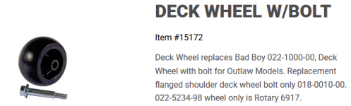

I have a 54" ZT Elites and the deck wheels are worn and it looks like the mounting bolts might be a bit bent, so I'm looking to replace them. I normally like to stick to OEM parts, but the squared off design they use occasionally dig in when turning on uneven surfaces, so I was thinking the crowned design of a lot of the aftermarket would work better. Has anyone found a good quality aftermarket wheel/bolt assembly?

The gauge wheels on my Rogue's deck are the rounded type. Maybe you can just get those to replace the ones on your Elite?

FYI: The gage wheels are not supposed to have continuous contact with the ground. If you are cutting at 3" or less, move the wheels to the top mounting holes. For anything over 3" move them to the lowest mounting holes.
