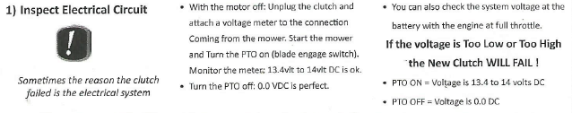

I would be either suspecting the charging system is overcharging causing coil overheat possibly damaging the bearings or overtorque of the crankshaft bolt causing a side load on the bearings causing failure. But could of just been a faulty clutch. been having issues with parts not working out of the box lately.
As IL said it can be a number that cause the bearing to fail so early. You have apparently the 61" deck which use the Warner 5218-134 PTO clutch. I would be installing the Xtreme X0216 clutch this time which a much better clutch. But voltage must checked and clutch must be burnish in. PTO retaining bolt is torqued to 55 ft-lbs.
From Xtreme installation sheet.

So can you suggest how this can be tested? Should I check voltage at a particular location to see if it is over charging? And what about overtorque, is there anyway the repair shop can test that?
