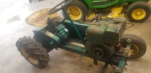

Thanks for the schematics - this will be very handy. As for the other pic of the oldie...I hope I am not older than that machine! My wife's grandfather had an old Cub from I think the mid 60's - well maintained - I mowed with it in the 80's, an old 3 speed, shaft drive unit. Her grand was an aircraft mechanic on the old radial aircraft engines, and he diligently maintained it until my wife's uncle inherited it and tore it up. I truly miss the simplicity these older engines had, even with some parts having shorter lives.
I wanted to post a pic of a 60s cub that sits on display in the office for everyone to see but every time I try to load it says it's too large.
