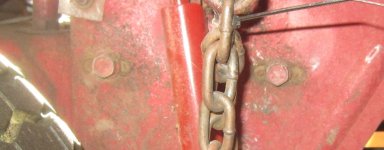

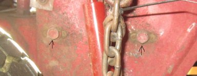

First off, just what mower do you have? Did I miss that info, perhaps? But on with the show! Disregard anyone's advice about 'gears. If what you have is the classic Snapper Rear Engine Rider, RER for short, the only gears in it are the sun gears inside the chaincase.not changeable. If you have an RER,the first thing to check is your shifter plate, the one with the notchs,1,2,3,etc. That plate is adjustable, fore and aft. Loosening the 2 bolts holding it on will allow it to slide. This shifts the top forward speed up or down and moves that speed to reverse. Simple terms, lose forward,gain reverse speed. Note that mine are in the middle of the slots. Give that a look firstSnapper shift plate.JPG
