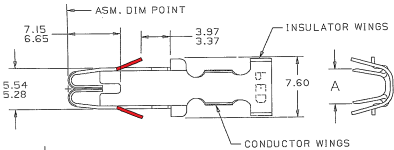

And to remove the current terminals you need to depress both retaining wings highlighted in Red in the following image at the same time. U shaped extraction tool.

The fuse holder is Exmark/Toro 32160-258
View attachment 71993View attachment 71994
If I am right the terminals should be
Pico 1598D, Aptiv 12020321-L, 16-14 awg.
If the fuse holder is un-damaged then only the terminals need replacing. And also need an open barrel crimper.
Lastly, would an electronics store such as Jaycar stock one of the " u shape extraction tools " ?
cheers
Don't know...but I have sent Mouser an email requesting info on a possible tool or at the least specs.
