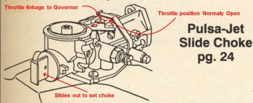

- Removed carb, cleaned all orifices and installed new diaphragm & spring kit, set jet screw 1 ½ turns out.
- Carb appears to draw fuel as small upper gas tank chamber had fuel in it when carb removed.
