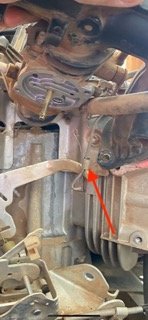

I have searched everywhere for this particular spring that slides over the linkage. I have a Husqvarna YTA24v48 (96045005200) with a Briggs & Stratton engine (44N877 0003G1). Can you help identify the part number for me?

I think they are calling the choke return spring. part number 592585.

Thank you for the reply. I was able to find the Choke spring (592585). Any idea what the other spring is? It is a link rod that the spring slides over. It appears to be a spring that possibly helps reduce vibration or 'chatter' on the link rod.Xnip2022-07-12_22-17-11.jpg

Thank you for the reply. I was able to find the Choke spring (592585). Any idea what the other spring is? It is a link rod that the spring slides over. It appears to be a spring that possibly helps reduce vibration or 'chatter' on the link rod.View attachment 61473
You are 100 % correct
Some engines have a small hole for it & some you just stuff in the same hole as the link rod after first puncturing all the fingers & thumb on your good hand
Thank heavens it is not sharp .

Thanks bertsmobile 1. You have been very helpful, That was a factory installed link with the spring over it. I think you are saying that you agree that the spring goes there. Any clue how I find it?

Well here is the problem
B & S did not fit one to the 44N877 0003-G1 engine or at least the IPL does not list one
AFAIK B & S only fit that spring to single cylinder engines
Kohler on the other hand do fit one to the Command series & it is part # 24 089 54-s
The equivalent B & S spring is # 260 584 well that is the only one I keep in stock & it goes on everything other than Honda stationary engines as they have a much longer one
In practice it does little other than to stop the throttle fluttering a tiny amount but to be truthful I think that is more in the heads of the designers than in reality
About 1/2 the mowers that I service it is either missing or broken & I am yet to see any difference spring on to spring off

Thank you so much!! I will go with the 1/2 of the mowers missing one and not worry about it :)
