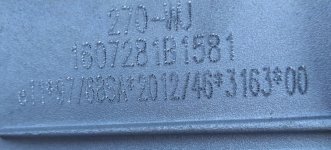

My cousin brought a MTD snow blower to me. He said he got it with no compression. The engine has the number 270-WJ. It looks like it has seen very little use. Oil looks almost new. I have never messed with a MTD engine. Not sure if there are any problems that are common to these? I was going to start with pulling the valve cover and see what the rockers look like. I did not find a parts listing for a 270-WJ a much more common engine was a 270-WU. It does not look like this engine has a compression release. I give it a pull and the engine just free spins. Anything to look for?

OK, it had the same engine as the MTD... It is a Troy Built... Better info always helps.
I give it pull and I get a couple spins. Bad rod?? Not sure no clunking. A couple pictures follow. They have so many numbers on it. I thought he 270 WU was the engine #... Not simple like the old Briggs. Pictures follow...

# looks like a 2012... It sure does not look that old.
Not sure if this is clearer.

That is a 270-WU and serial comes back as 2016 engine. As well it is printed on the EPA sticker.

That is a 270-WU
OK, The U is printed in the W pretty close on the etched #. I see it now on the tag. Maybe best bet is to tear it apart and have a look inside. Maybe a quick look at the rockers first. Oil looks very clean.
