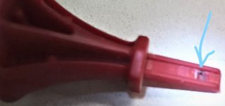

running for only 40 seconds in the cold can foul plug, besides leaving it wet.
on a different note, no start at times.....
kill knob burnt through shorting intermittently!!
