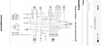

Thank you for the response. I have the wiring diagram. I believe the coils have a single wire running from the ignition to shut them down and turn the mower off. I will post the pics maybe it will help you

If you follow the single wire on the magneto you see it goes to the "Hour Meter Intermodule "
If you look at the ignition switch you will see it has no ground contact
Therefore the key switch itself can not make the ground contact for the magneto
You will also see on the diagram that all of the safety switches connect to the same module .
This means that the module has a chip in it that controls the mower & in particular turns the magneto on & off
If the white wire at the engine to mower plug is not ground with the mower turned off then the module is cactus & so will be your wallet .
Check all of the connections going to the module every wire should be battery voltage or open circuit depending upon weather the safety switch is NO or NC when you are mowing.
