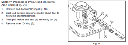

Remove the mixture needle and seat. Check for clogging there. According to the IPL you this type of carburetor.
This is instruction on removal of the part.
Reassemble by reversing the directions.
103
11,833
Rivets if you look at the picture of 681 (pn 395508) you see that I am right about the part.
Now there are two version the mixture screw setup but IPL indicates it is Fig 21 setup.
And there are three choke systems that could be used. See figures B,C, and D. In this case it is either B or C.
