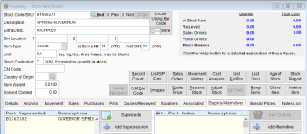

Mike, if you would take a little more time and look closely at the pictures in Sec. 4 Page 12-13 and 16 you would see where the spring is attached. The diagram doesn’t contain the spring you need, and only an experienced tech would know how these governor systems work. You engone was built in 1996. You are correct that it is attached near the bottom, Spring part number is 692208, superseded to 796260. It goes between the governor control arm on the engine and speed control on the tank bracket.
Rivets are we looking at the same IPL? I don't see type 0146 listed as one of the other governor springs.
