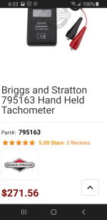

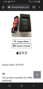

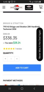

Gees you lot like to spend money
I thought buying the Fast-Tach, Wireless Handheld Tachometer $103.00 ( 4th one on the list ) at $ 100 was being extravagent

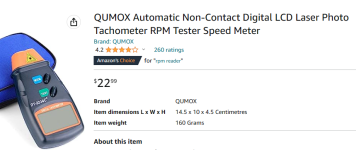

thanks for all the advise. So, will something like this work for me then? And if it will, is it a case that I aim it at the spark plug?
Get the cheap one like I did at 11 bucks to your door. You don't need NASA tools for mowers. I wouldn't get that kind anyway. Mine simply wraps around the plug wire.
