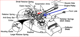

Replaced brake arms, pivot plate, clutch cable on the deck. I'm pretty sure I got the stationary idler pulley on correctly
Put on a new belt as well. Advertised to be 95.5 inches. p/n 144959 is marked on it.
Started engine and the blades turn furiously with the clutch disengaged. Turned engine off.
Clutch lever does actuate the clutch idler properly and there is slack in the belt with it disengaged. Just not enough.
Attempted to adjust the "arc" of the stationary idler and it does change the tension on the pulley but only gets tighter. Red arrow points to the idler.
My only thoughts are I installed in incorrectly, or this new belt is actually too short. Too late in the day to hunt up another or dig into it any more today.
Suggestions?

The "idler" is the one pointed to in the picture I posted, not the "clutch" pulley? When I tighten the holding bolt for that, it is stationary. Rotates on the bearing but does not move otherwise.
If that is supposed to be free to adjust itself then I assembled that part incorrectly. I'll take a closer look at it. This is what comes of not taking notes when taking things apart.
Cusser
May 3, 2019
228
On my LT1000, the idler with the red arrow is stationary, the pulley just spins freely. The one with the blue arrow is the one that must be free to slide in its groove in the deck (that's what engages the belt/blades).
That's how mine works.
Ordered a PIX A93 belt, we shall see if that measures longer.
If all else fails and they all seem too tight, I guess I can shorten those "front link" a bit, if there is thread left. That should move the deck forward and make the belt slacker.
No idea how far I can move those and if it will cause issues with the other arms. Looks like they are free to move about some.

This appears resolved. I put the D&D belt back on after shortening the front links several turns and the blades do not move at idle. A bit "stiff" engaging the clutch, but I understand it will loosen up after an hour or so.
Thanks for all the advice.
