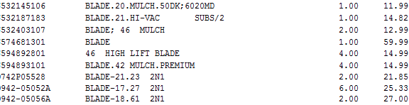

What I see as the removal of the original cutting edge is about one third. But any cracked, bent, or broken blades should alway be replaced. Considering I charge a minimum of $9.00 plus sales tax the follow blades are border line sharpenable.
