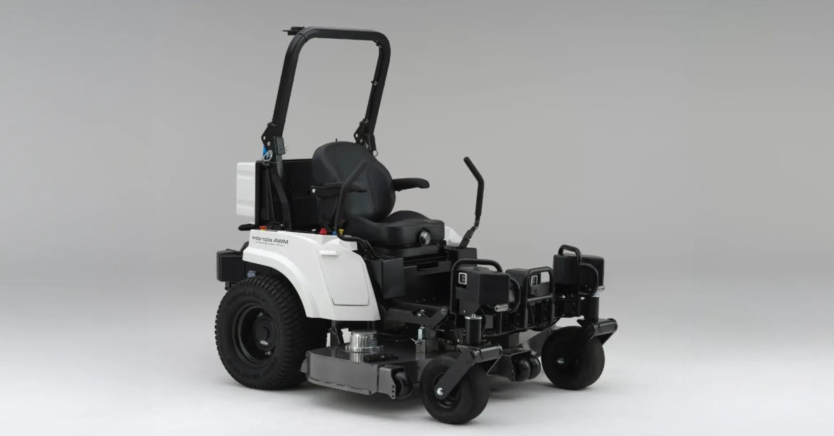

And then Honda secretly does this in the background
I don't know about you but I'm not at all excited about all this EV stuff. I mean some places I see where it might be effective, but if you've got multiple yards to cut a day or even if your yard is huge, would it last a charge. And then you have to worry about maintenance cost. Batteries are by no means cheap. And there's no telling how much the motors would cost.
