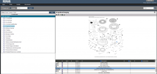

Posting the engine spec would resolve the question of what was used on the engine but as I said the two engines list by spec number for the JD G15 both had 15/20 amp stators and half wave rectifier / voltage regulators.
Yes I actually look up both engines on Kohler Plus and wasn't just guessing at the info. I hate it when someone just posts something without even taking the time to actually look up things. That is like me telling the Amaco transmission shop that I need the fluid and filter changed in 700R4 in my '79 Malibu. Instead looking they just wanted to argue with me. I won a $20 bet plus a free fluid and filter change for it as I was the one that put the 700R4 in it. Boy that was a nice steak dinner.

Then I wonder why they have a 25 403 37-s listed as the correct unit on their parts lookup on Kohler Plus. And then what is the correct Kohler PN?
