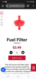

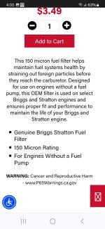

The fuel filter I have is an aftermarket one. This is the genuine one for the engine but it looks very similar to me. Is it worth buying the genuine one?
#12
when I disconnect the fuel line the fuel floods out and I get covered in petrol (gas?) then I reconnect it and the filter fills up immediately. It's a big mystery. Is replacing the carb a big job I can do? Another friend did suggest it might be the fuel solenoid but the mower guys did not suggest this. Again not sure if this is something I can replace on my own :)
I had a thought of fuel solenoid on the bottom of the carb. You should hear/feel it click when the key is turned from off to on. If you run it long enough to die and then turn off the keyswitch and back on, you should hear/feel it click. No clicking when hot could be the issue.
#13
H
hlw49
25 050 21-s Is the Kohler filter for the gravity flow system. It is the filter I use on the non-fuel pump systems. If you use the 24 050 13-s it is a 10 micron filter and the engine could run for short peroids of time and shut off.
