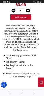

I am a sixty-year-old woman who lives independently, with an acre garden and a Husqvarna ride-on. It was built in 2006 and has been very reliable and I have it serviced every year. It only mows once a week for about 2 hours max in the summer.
It seems to be suffering this year and I had it serviced but then developed an oil leak from the valve cover which I managed to replace myself. Now when I run it seems to go for about 10 minutes and then stops. The fuel filter is empty. The guys that serviced it came back and blew compressed air through the fuel system and replaced the fuel filter but the problem persists. I think they have given up with it now.
Anyone got any ideas? I am happy to pay for some repairs but it is so hard to find someone reliable to help me and to have the persistence to get to the bottom of its problems. It runs fine and cuts fine. When it stalls the only way to get it going is to disconnect the fuel filter and let gravity fill it up again. Then it works fine for another 10 minutes. It is a Kohler engine - see attachment.
Thanks in advance for any advice

"When it stalls the only way to get it going is to disconnect the fuel filter and let gravity fill it up again."
Does it have a fuel pump or is it a gravity system?
Is the fuel filter the pleated paper element type?
no fuel pump just gravity
yes the fuel filter is the paper type but I replaced it today and no difference

Remove the paper filter and replace it with the round red screen type. Some paper filters are not compatible with gravity systems.
I don't use the red ones on anything. Had too many cases were debris would get through the filter and preventing the float valve from sealing causing overfill and gas in the crankcase issues, I prefer the white ones for gravity,
